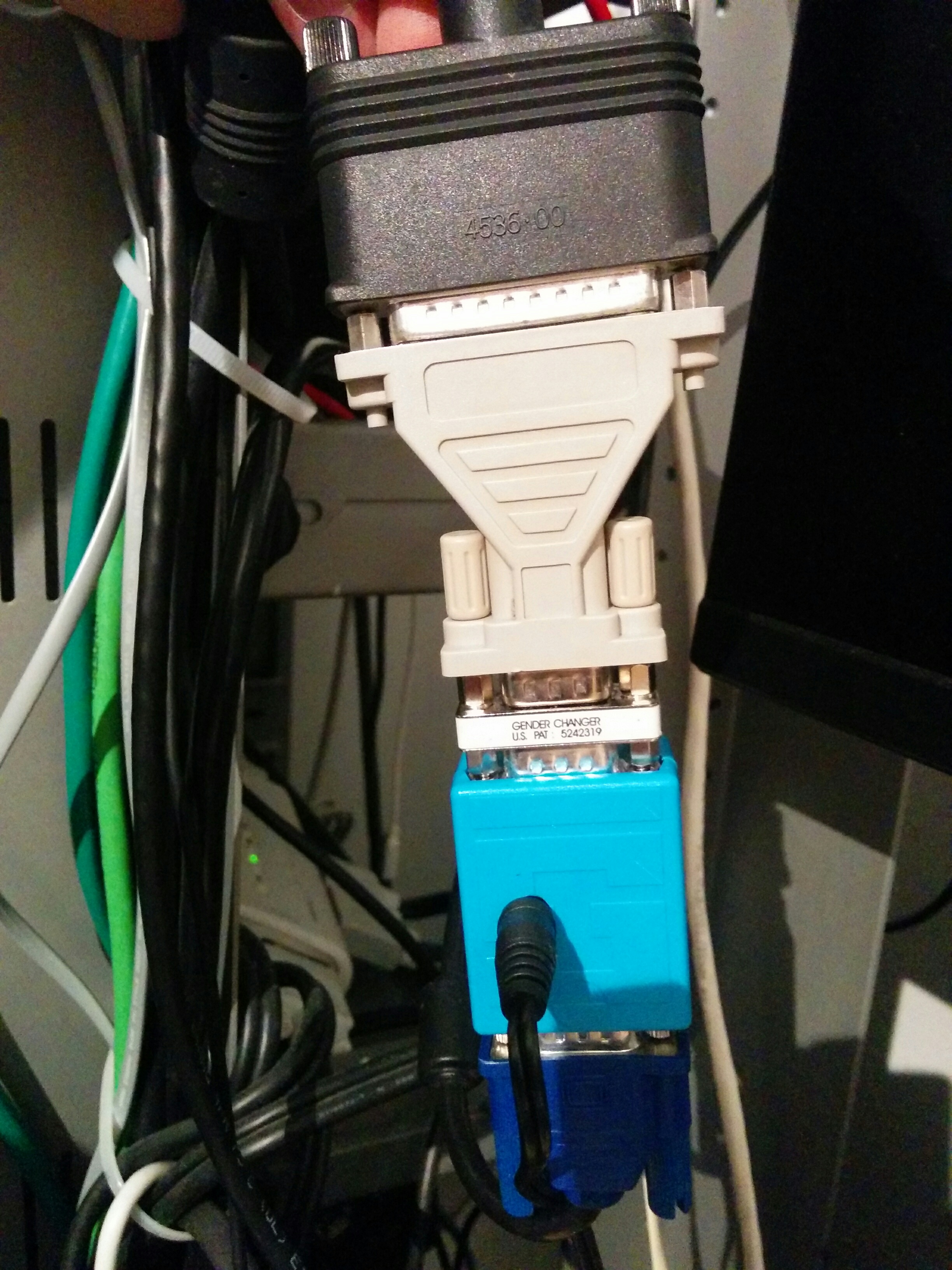

PostPosted: Sun Dec 20, 2015 4:57 pm    Post subject: SOG Reply with quote
Initially mine wasn't working either and then I read that the SOG device only works in one direction. Make sure you have it connected in the right order. Here's how mine is set up:
13W3->VGA
VGA gender changer
SOG device
VGA cable
HDMI converter device
HDMI cable
Monitor
Here's what it looks like:
rcberwick
Joined: 17 Oct 2010
Posts: 22
Location: Cambridge, MA
PostPosted: Mon Dec 21, 2015 9:03 am    Post subject: Re: SOG Reply with quote
Success! This indeed works! The problem was a bad HDMI cable. I had tried both orders for the SOG box, then switching out to a new cable worked - and the display is really quite excellent, just as rjbrown99 says. Good rez., a small black border at the bottom. Closest thing to the old Megapixel color monitor I have yet seen, and it beats the smaller Dell LCDs. A tip of the hat to rjbrown99, thank you for all, and the care in even sending a photo of the setup.
