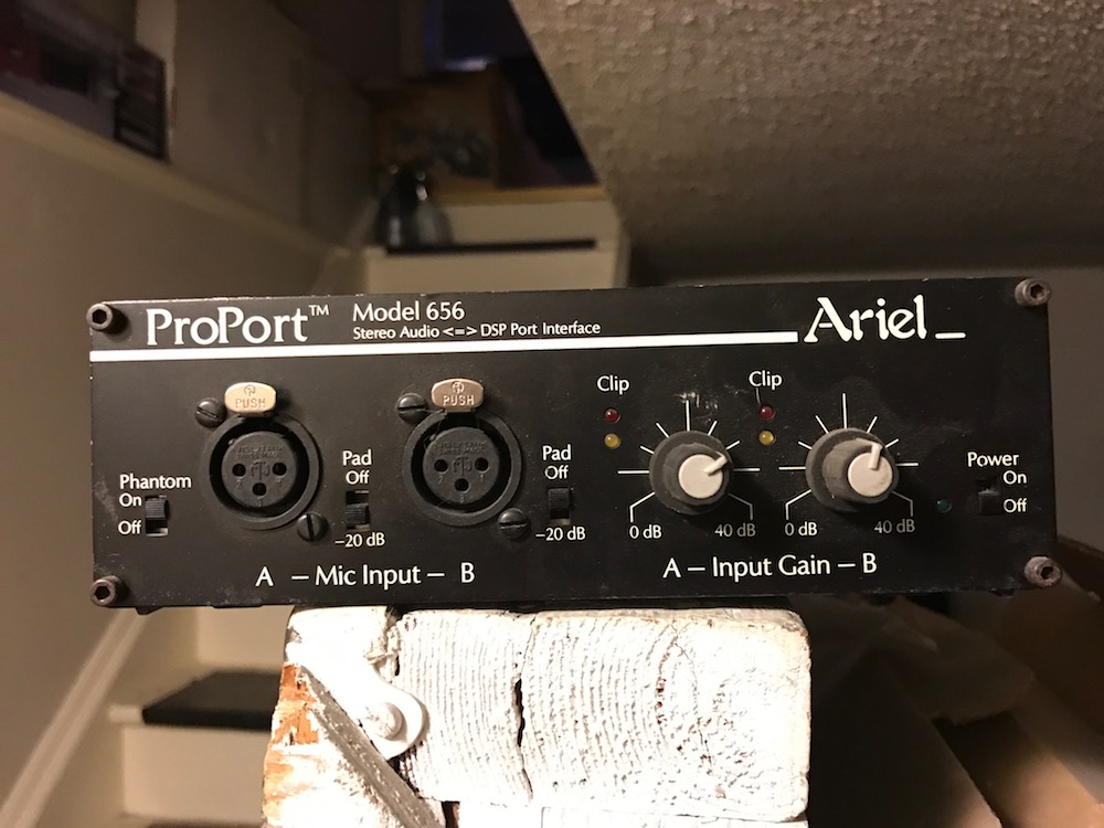

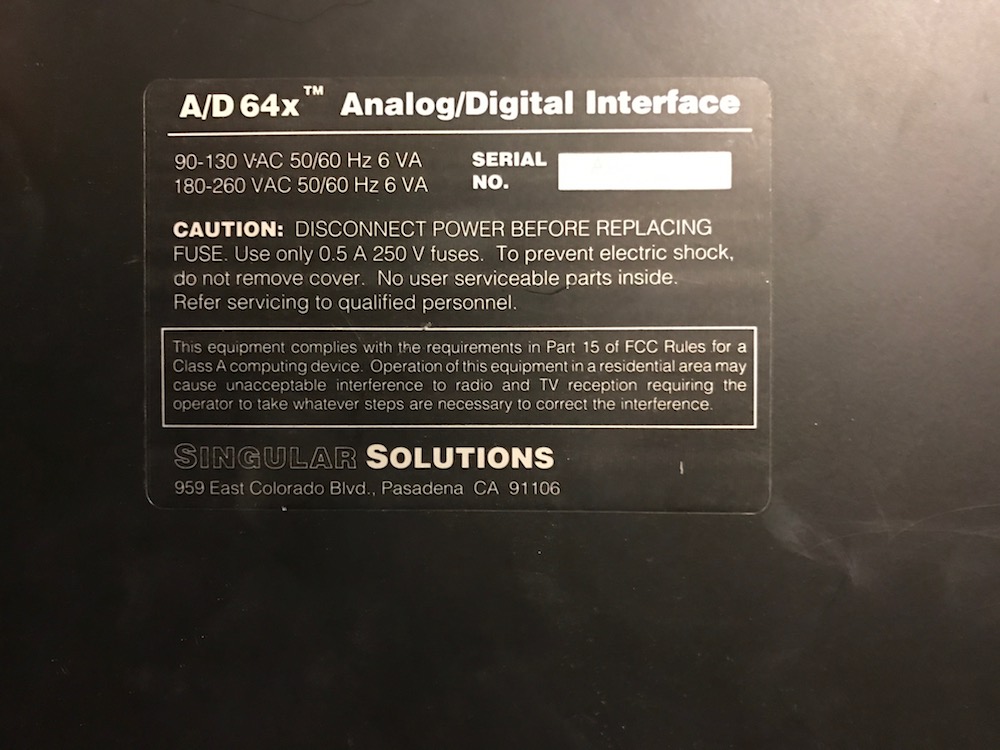

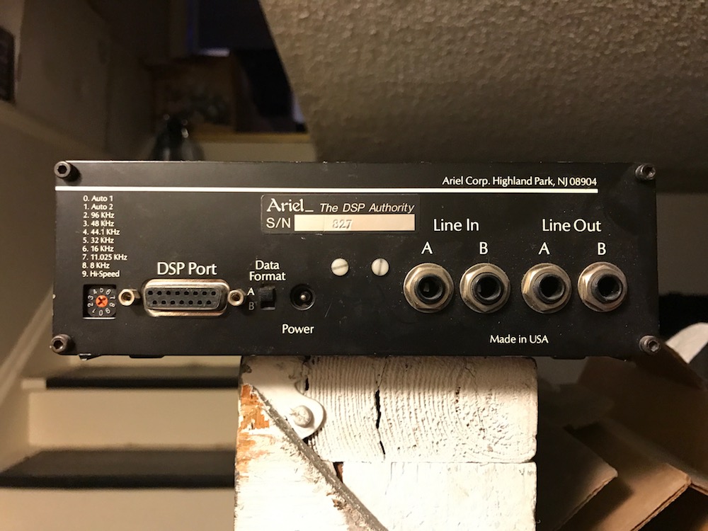

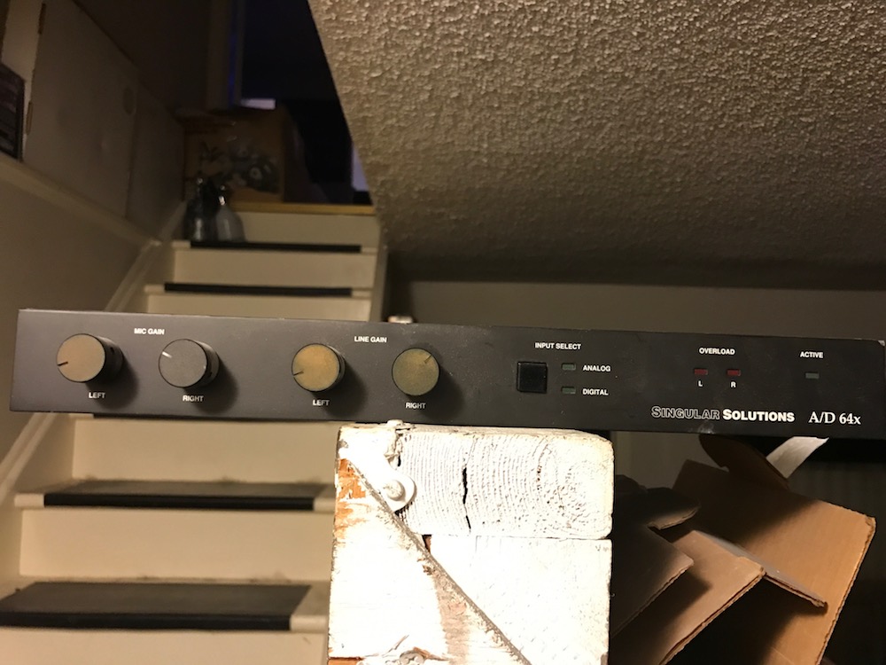

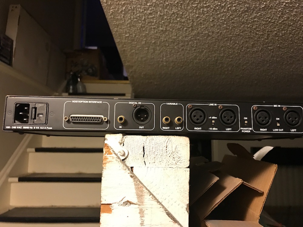

Hello : Totally cool , it may be worth trying to repair the hard drive or hard mount it to see if the software is recoverable and look at it with a second drive. Brian Archer on the forums has had success replacing capacitors on doa hard drives and getting them to work. I probably would have a surrogate drive and if all else fails if you want to send the drive to me I'll see if I can get it to boot or hard mount and copy the software off it for you. No charge other than shipping it would be kind of fun or if you have the make and model of drive and want to try it yourself I probably have an identical drive. I have have an analog to digital convertor external box that was used with a NeXT cube at one point maybe this was how.
